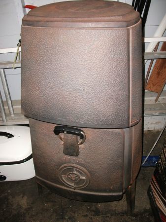

I am considering a Jotul Combi-Fire 4 advertised locally, but so far have only a photo of the outside which appears to have surface rust. The seller says some of the fire bricks are broken and it needs a new door seal. He was asking $350 but says "I would be willing to drop the price if the bricks are an issue."
Of course broken fire bricks ARE an issue; is there a source for these fluted bricks or a reasonable substitute? And what might one be looking at cost wise to replace firebricks and door seal?

Don't worry about the slight surface rust, but do look for cracks and issues with the door mechanism. If all is ok, the stove can be made to look like new with a wirebrush, cleaning and fresh stove paint.

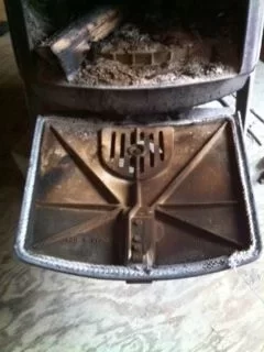

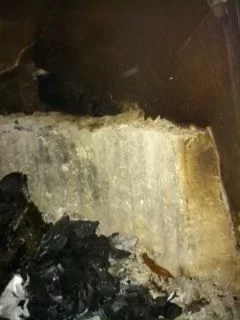

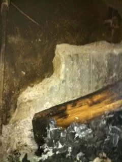

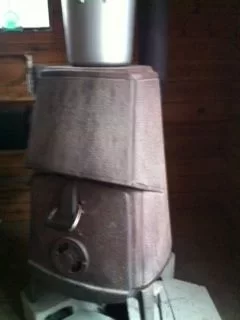

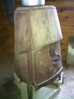

The seller sent some more photos of the inside and it looks pretty rough (see below), but I will try to go see it if he still has it. I've seen folks postings who have gotten these for anywhere from free to $50 to $300 (in good condition) and even one offered for sale at $900 plus. Any idea what one should offer if all the parts are there and the door latch works even if the inside needs completely re-done?

I would call both Woodmans and Preston. They may be able to provide a lead if the facebook page can't. The fire brick does look rough, but the stove looks pretty solid still.

Just spoke with the seller again who says there is only about 5 square inches of firebrick missing and that he's used the stove that way for 20 years, but he has rented the house now and he wants to move it out. He says everything works, but he has had to replace the door seal almost every year because it doesn't stay glued. His bottom dollar is $300 and he is moving it today to a cafe he runs to put it in the parking lot with a for sale sign. He'll call when it is moved and I'll go take a look. That's pushing my budget but I'm thinking I'll bite the bullet if it is as solid as he says.
Well, good and bad news. Aside from surface rust the Combi 4 was solid with all the parts and the firebrick was not that bad once the 3 inches of ash was shoveled out. The door worked fine and the handle was perfect so I bought it for $300. However, the seller had a couple of buddies to help move it out of the rent house and they boomed it down face first on an appliance dolly and broke the handle. I was sick!
