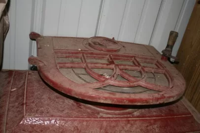

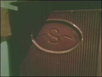

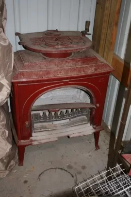

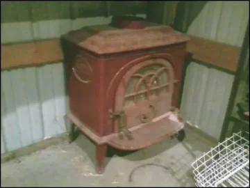

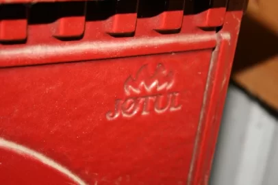

That's the spin-draft kind, i.e. the 1st generation. I have/use one of those as my exclusive woodstove this year (supplemental to my heat pump).

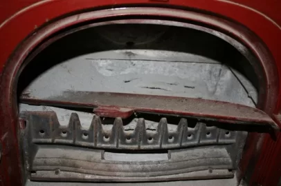

There are no firebricks in this stove, only steel liners on the sides and back (back plate acts as a perch for the baffle/flue exit) although I added some firebricks on top of my baffle to help extract more heat from the stove (tends to spill smoke out when opening the door unfortunately but that's worth the bother to me). It can be top-vented or rear-vented, and that can be switched by unbolting the cover & flue exit collar and installing them in the opposite locations (looks like yours is set up as a rear-vent, that's better for heat extraction IMO, I converted mine from top-vent to rear-vent intentionally)

Also, when cleaning it, be sure to remove the stovetop (it lifts right off--check the rope gasket, might be a good idea to replace that), upper baffle, then all the steel side/back plates, then after cleaning the ashes off the bottom plate--remove the bottom plate and thoroughly clean the ashes out from between that bottom plate and the bare bottom iron casting. That space between the bottom casting and the ash plate (where the ashes/wood sits) is an air channel for the stove's rather rudimentary "secondary burn system"--where air comes through the lower slot in the spin draft, under the ash plate, between the steel side/back liners and the outer shell of the stove and enters the upper firebox. When you have a huge load of wood in there and it's burning there in the upper firebox, you can get some serious secondary combustion action and the chimney should be totally void of smoke. Nice clean burn. Not as fancy (or reliably clean of a burn) as the newer non-catalytic burntube stoves, but not bad for 1984!
