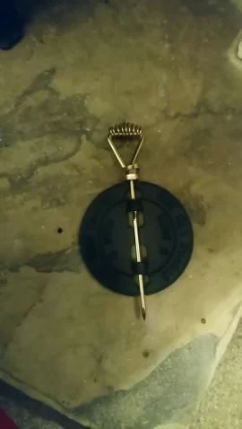

Thanks for replies. Only just seen them! So..... since I last posted (happy Christmas by the way!) I ordered and fitted a damper into the black flue pipe. I was slightly disappointed that it didn't totally slow things down but it has definitely made a difference and I can now shove more in the fire box without worrying too much about things getting too hot as I can shut it down enough to get a slightly smoother, slower flame. You can actually hear the air slow through the top vent when engaging the damper.
I've definitely gone through less wood these last few days. Ideally I would like a little more control. I'm wondering about modifying the top slide vent on the stove as this seems to be the one that does not entirely seal..... Then again.... Maybe I'm asking too much of a 30 year old stove.
