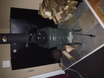

Thanks for the information Pen. Yes it's my 1st stove and I'll send pics if I can do so.
I'm having an issue with the pictures not uploading properly. I don't know how to turn them to be seen better.

How far away from the heat shield are you? Did you install the heat shield with 1 inch spacers off of the wall? What's the distance from the stove to that dry wall and the firewood you have stacked there? How far from that door / ash fender is it to the front of the hearthpad?
That's a nice looking stove.
pen
Did you follow these guidelines when installing?
What's under the tile for backer?

That is just one page from the manual that I believe fits with your stove. Here's the full manual that you may really want to study as your insurance company will generally want these guidelines met or exceeded. (broken link removed to http://jotul.com/us/guides/_attachment/12835?_ts=13e1d3d1aec)
