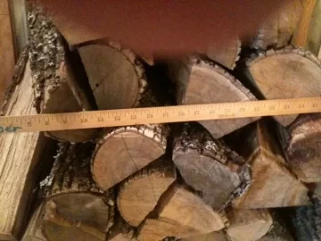

I prefer to use about 18 - 20" long and maybe 3"x3" square. Since I purchase my wood normally I have 15 - 16" on hand and 4 - 5" square which I feel is too large, but it is what is most commonly delivered.
Chris
Ok.. I use 12-16 inch about 3 inches thick or so.. I use red oak now n I will have a ton of maple for next year. I wanna start getting in the habit of splitting larger pcs . I'm assuming that's why I'm not getting as long of a burn time
Typical from the last ash I purchased. Just as they came. No idea if they are a proper size. I can only get about 3 or max of 4 in the firebox. In my limited experience these seem to last about an hour each with the air shut down. About 17 inches long.

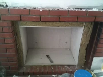

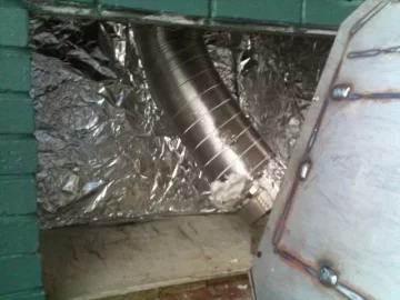

The stove front got up to 600 degrees at one point with the 3 logs in so it does get hot. Have the blister to show for it!!!;em. Can't answer as to how it heats the room it's in yet as I had not closed any doors to other parts of the house. We're changing our casual living arrangement to downstairs from upstairs to the area where the insert is located. After we get down there I'll have a better idea. My chimney is an exterior chimney but when I pull out the old slammer insert I insulated it with roxul and durock. Put in some heavy duty aluminum foil on top of the durock. Don't know if that will actually help any but was simple to do so what the heck.
[Hearth.com] Jotul 350 winterport insert [Hearth.com] Jotul 350 winterport insert
Durock is a cement board about 1/2 inch thick. Normally used for backing material for tile. Comes in 3 x 5 sheets for a few dollars and is available at any home improvement big box store in or near the flooring department. I got the idea from reading this forum. I'm guessing that if you have an internal chimney it's not really needed.
