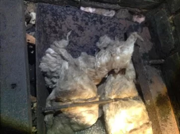

-- House was built in the 1700s with a masonry chimney. Damper plate was at the bottom and stuffed with installation below it. There was soot and brick dust, preventing the opening of the damper. Installers came to inspect, took measurements and said that chimney could be operational with removal of damper, an insulated liner & an insert.

-- We continued to feel drafts from the chimney through the edges and beneath the insert, as well as heard dust fall down onto the stove. We decided to pull out the stove and remove the top plate to see what was going on. Although there was an insulated liner installed, it clearly appears the masonry flue was not cleaned at all before installing the liner.
-- Also, there was no insulation at the top and the insulation at the bottom had multiple air gaps.

-- At this point, we were planning to install a block-off plate with more insulation above the plate and within the firebox and then doing the hearth so that it's level across the bottom and has the proper clearances, but are very concerned about the creasote buildup in the old masonry flue. A short phone call to the installer about this condition resulted in a response that "we have nothing to worry about with an insulated liner. the installer's been doing this for 44 years and you are being unreasonable" which clearly seems to contradict what has been written in these forums in the past.
