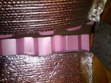

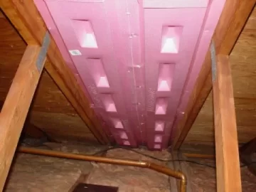

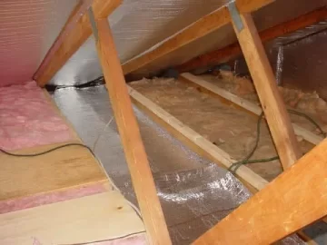

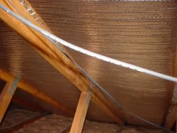

So I put in the styrofoam proper vents from the soffit to the ridge between the rafters and covered them with reflectix foil all from home depot.

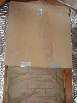

So I just finished building plywood doors to cover up the 2 Gable Vents for the winter! Just got the last one done over the weekend.
I cannot tell you how much of a difference. My daughter says she can now sleep better at night because her room is no longer drafty
The Pellet stove now can heat the 2,000 sqft house on heat setting 2 and then bumped up to heat setting 3 early in the morning on colder nights like last night when it was down to 15 degrees. Before I bumped it up to 3 at 6:30 AM, the livingroom was 67 degrees and really not bad. No more draftyness from the roof!!
So beware of Gable Vents and Ridge vents in open attic spaces during the winter!!
See pic of snow maps below and Closed Gable Vent!!
