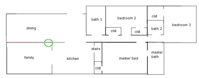

Rated to heat roughly 1200 sq. ft. My entire house is 1650 upstairs, which is the portion I've included here. My main goal is to keep the family room, dining room and kitchen warm. This is where we spend a majority of our time and we typically only sleep in the bedrooms. It would be nice if some of that heat moved into bathroom 1. Our idea is to remove the wall in Red and place this stove where the Green circle is.

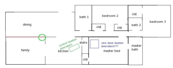

Our basement is under the entire house except bedroom 3. Once properly insulated, I think we'll see some gains down there, but in the future we may opt for a newer, cleaner, more efficient, LARGER stove down there. One that is rated to heat at least 2000 sq. ft. Then we can burn small hot fires and have the option to really crank it up.

Morsø 7642 is the stove model.
