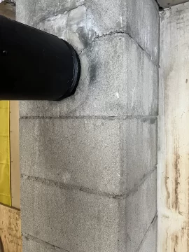

I got a great deal on a drolet HT-3000. I purchased selrick double wall stove pipe to meet ceiling clearance. Menards had everything except the masonry adapter. I have one the way. I put it all together today and at first the adjustable double wall pipe would not fit in the chimney flue. With some light tapping it fits very snug. Is this safe or is the masonry adapter required.

The liner has not been installed yet. The current chimney has a clay type liner that appears to be good condition
But it doesn't meet code.
You need an insulated liner and a snout to connect.
Congratulations on the new stove. If the chimney doesn't have 2" clearance all the way up from any combustibles, it needs an insulated liner now to meet code. Hope this is the plan.
Only the inner liner of the double-wall stove pipe should connect to the chimney. You don't want smoke coming back or leaking into the outer jacket.
