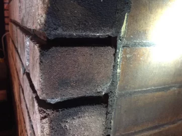

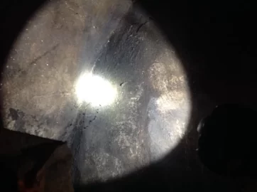

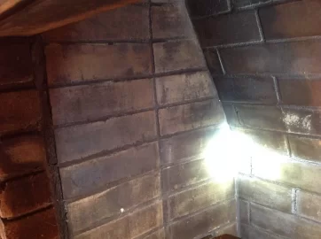

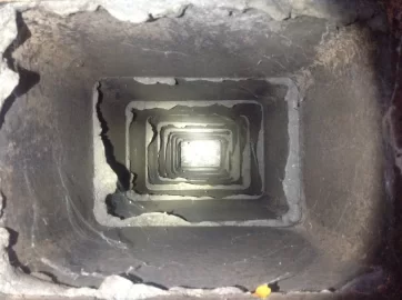

Its normal sloppy work. Masons rarely take much care to make the inside of a flue or Fireplace look nice. A brush will go down it ok though.

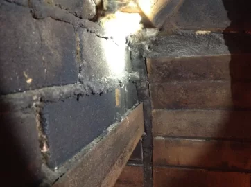

If each of those tiles is quite tall wouldn’t it be hard to reach in to knock that mortar off during construction? Also risk knocking it out of plumb when the mortar is wet?
They are 2' tall. It can be a little bit of a pain but definatly doablePictures sure can be deceiving, the depth is about the distance from your elbow to your hand and the mortar is about an inch thick, I don't see it breaking off, the house was built in the 80's.

No that is extremly high unless that includes the liner install as well. And the 2000 would be high unless it included the liner and install. I would bet that is the price she was goving you. But i agree with squisher it doesnt look very dirty at all. I would run chains anyway to knock off as much of the mortar as possible if not taking out the liners to make room for insulation.I searched for a certified chimney sweep in my area to remove all the creosote before I install a liner, she was very nice on the phone and explained to me the different stages of creosote, she kept mentioning that she was not cheap, starting anywhere from $1000, to $2000, depending on the severity of the creosote. I know it's a messy nasty job, but does that price sound average.

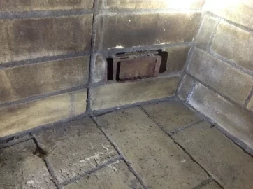

What are you installing, stove, insert? I think you're taking this farther than it needs to go. It doesn't need to be free of any discoloration and a sweep is not going to bring it back to what it looked like when freshly installed.
Take this for what its worth but if the pictures you sent are actually representative of how it looks you're already good to go. Get an inspection, let them brush if they think they need to and go. If you want to clean up the firebox for looks maybe some TSP.

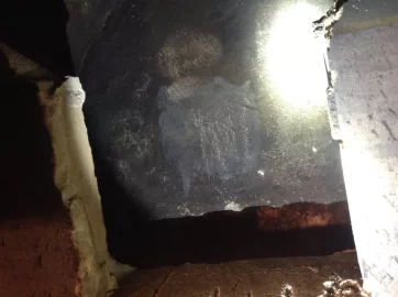

From the pictures from the other thread you had scorched insulating material. It was hard for me to tell where that was in the system but as far as I can tell that should not be and maybe was the main reason for smoke in house (?).
