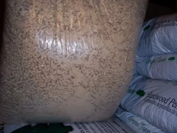

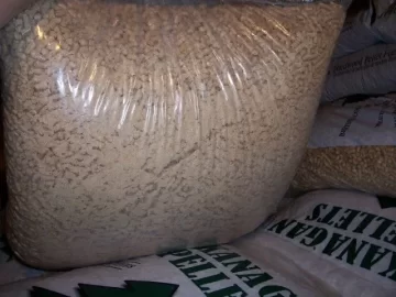

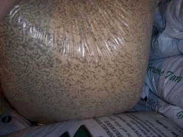

Newbie question time:
Not sure if this is normal or not, but this is what I am getting on all bags of Okies from BJ's in Portsmouth NH.
These were bought about a month ago. The bags at the store today had similar amounts. They did now have Okies in white bag versions. Is there a difference between the 2 bag types? I was not at the store myself today, so I dont know if the labeling was exactly the same or not.
I dont know if I'm just use to the solid white bag of the Greene Teams in the sense of not being able to see the product, but if dumped into the hopper, the Okies are "dirty" and so is my hand if I sift through them at all. Not so with the Greene Teams. Much cleaner. Maybe a hardwood (GT) vs softwood (Okie)?
edit: kind of hard to get a good picture as the fines move as soon as the bag is picked up.

I can't speak for all bags of Okies.
But, the pallet of them that I bought at BJ's in Taunton, Ma had no fines. Every bag was in great shape.
I had them (BJ's) load the factory wrapped pallet directly into my truck and they were never disturbed from the pallet packing until I got home and had to hand unload them into my Basement.
I know it is not possible but I swear they were even still warm in the center of the pallet (ok it just seemed that way :) )
I would guess the Okies you got from Portsmouth were over handled by the store. Perhaps moved around a few times in shipping or storage in the store.
As a rule, I am of the camp that doesn't worry about fines. My EF-2 burns almost everything I put into the hopper. I don't "clean" the pellets first. I just open a bag and dump it in.

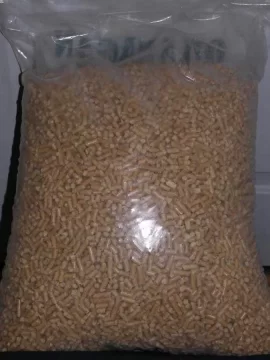

No excess fines from the pallet of Okanagan Pellets (clear bags) I purchased from BJ's in Haverhill, MA
I also received six WHITE bags of Okanagan pellets free from my stove dealer when I purchased my stove in September.
Absolutely no difference in the amount of fines when comparing the white bags to the clear bags.
Maybe it's my imagination, but the only difference I noticed between the white bags and the clear bags is the gauge of the plastic used in the bag itself. I find the plastic on the white bags to be slightly heavier vs. the clear bags. The white bags seem to resist punctures and tears a little better than the clear bags. Again, it could just be my imagination.
White bag or clear bag makes no difference.....these pellets burn amazingly well!
Now those look like clean pellets. Night and day difference from the 65 bags that I have. Guess Portsmouth BJ's has a different lot, or different handling as Haverhill.
I know that's it's fuel and meant to be burned, but so is cheaper, no name/lower grade gasoline. It will make your car go but you might pay more for maintenance or repairs later due to deposits in the engine, you might not. I know from being on the site for a while now (even before joining) that so much is talked about with fines. Maybe too much is put into the sawdust talk here, I dont know. What I will now learn first hand is how my stove accomodates them. Hopefully without any issues at all and they just go up in smoke :).
BTU, this is not a negative towards the product as much as it is letting Okanagan know that a retailer has alot of product that is sub par from what they would like to see. Whatever the reason. Your retailers are your final advertisement. The bags in Portsmouth have been like this since the day they had them for sale. If I had seen the difference in bags from Haverhill to Portsmouth, I would not have touched the ones I bought. Who would when there are plenty of options out there right now?
Bottom line is that they produce great heat, hopefully without any side effects.
