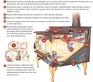

yup, it looks like that. I just read (quickly) the manual on the Spokane 1196. and my question was if cat and secondary are the same. you answered it before I asked it. thank you very much. my stove doesn't look exactly like the 1196, it looks bigger. I know it kicks some serious heat and burns quite long. very happy with it. I would have rather had the money over the stove, but it is what it is.Your stove is not a catalytic stove. It is a secondary combustion stove with reburn tubes installed beneath a baffle in the top of the firebox. The insides & workings of it are undoubtedly just like a Lopi Liberty:
