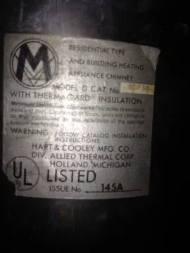

So I'm installing a used woodstove (Lopi Leyden) in my home that has an existing chimney from a long ago removed stove. The existing chimney is 8" stainless steel with a label reading :
Residential type and building heating appliance chimney. Model D Cat No. 8dp30
Hart & Cooley MFG CO.
UL listed issue No. 145A
Now from what I've learned the Chimney pipe for a wood stove is supposed to be listed with the UL 103 HT classification.
Also the current chimney is 8" and the stove is set up for a 6"
I really don't want to spend the $500 to put a whole new chimney in but I also don't want to burn down my house. Any info is appreciated

  • is my old metal chimeny safe to use???

I was in a similar position a few years ago. I had air-cooled older triple wall stovepipe in the house, but 6" inner. It passed inspection by a local chimney sweep and also home inspector a few months prior to that. After burning for a year with an old stove, I decided to change the stove to an EPA style, and at the same time my insurance company wanted a "professional install". I did the removal of this old chimney myself and hired a local CSIA sweep to reinstall Supervent double wall SS from Menards. To my surprise during removal of the old pipe I discovered that water had rusted the galvanized outer layer in a hidden spot which caused the lath to be charred where it passed through the ceiling.
Not trying to fear monger, but put into perspective the real cost of replacing that chimney. I realize not everyone has had this problem, but nobody says much about the life expectancy or failure modes for stovepipe.
If you do re-use the old chimney, best to be darn-sure it is in good condition and give it a full inspection.
To get your stove performing the best it can, matching the stovepipe size to the stove outlet will be beneficial to draft/stove performance, burn times, and not having smoke spillage when opening the door.
This may take pro eyes on site to determine its condition. It could be rarely used and fine or it could be deteriorating. Hard for us to say. It's an older pipe so it may not be rated at HT2100º.
The Leyden can be a fussy stove to run and quite particular about draft. It may be balky and puff back a lot with the increase in pipe size plus a bit short chimney.
It also sounds like he might be top-venting, then a couple 90s into the chimney. :oops:
