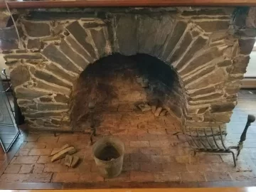

Attached is a quick photo of the fireplace in question. Yes, if you look carefully you will see that the back (right of center) needs to be repaired.
I really just would like to know if it's absurd (from a professional's point of view) to try to do doors with a 6" flue liner. To a consumer (me), it's a small liner but with doors it drastically cuts down on the draft that's allowed and seems like a doable fix. Thoughts?

A few thoughts:
Why do you want doors?
I assume this is a one and half storey house?
Is the chimney made of stone top to bottom? If so any idea as to its wall thickness?
The firebox to flue ratio may be a problem, but if this build works then it works. You'd have to use to find out.
In my opinion, it may be possible to repair the firebox as needed and do some version of a pour in liner. I know of 18th C chimneys that have had pour in and work fine and are safe --- especially if use will be occasional and an open fire, as opposed to a wood stove.
Doing a 6" liner, doors etc, not to mention $50,000 rebuild is a bad idea all the way around. Btw all sweeps, chimney companies will say and unlined flue is unusable, does not matter the condition. It's against code.

Also, did they do a camera inspection of flue. You can do your own amateur attempt as well.
And I forgot to say that is a beautiful fireplace. I'd bet the chimney is built like a tank if all stone. Stone chimneys hold up much better than brick, as a general rule.
The chimney clearly already suffers from poor draft as indicated by the heavy staining above the firebox. Downsizing it would make it not work at all doors or not.
And all sweeps will tell you that unlined chimneys are unsafe because that has been proven to be true over and over again. Yes you can get away with using one untill you don't. And the older it gets the higher the chance of something going wrong.
If the condition of the firebox is any indication of the condition of the flue (which it usually is) it is extremely unsafe to use.

No didn't assume a thing. The chimney is unlined. It clearly leaks allot of smoke. The firebox and hearth floor are in horrible shape. All of that adds up to the fireplace being unsafe.
I disagree. Put a fireback in that. Remortar, replace loose stones. Put a bed of ash down and there you go for a test run. But I would ideally want a camera inspection of flue. Unlined stone chimneys can be very safe. At least as built in colonial New England. Craftsman period may be a different story. Personally I would like to know what flue looks like.
Disagree based upon what information?
A fireback in a firebox shaped like that will push the fire forward pretty far making the smoking worse.
