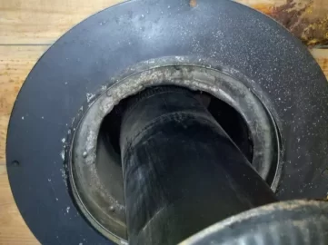

We have occasionally noticed smokey smell in house, attributed to stove door being open. But, have discovered some leakage at thimble and one of the stove pipe junctions lately. Was exaggerated the other night when it was very windy (house was pretty smokey, scary moment). Will post a pic below to illustrate. Talked to a stove/chimney guy today and he thinks that lining chimney is 1st and foremost to do given smoke leaking back into house.
So, here are my problems that i can identify (going to restrict to the woodburning stove as goal is for it to be primary heat source):
1) Unlined chimney
2) BAD thimble/pipe interface.

here are pics
  • [Hearth.com] Is it worth fixing our stove/chiimney- LONG post, need BIG help
What's on the other side of that thimble?
goes through the wall into masonry chimney, no liner... about 25' up to top and about 6-7' down to grade. Horizontal run of pipe terminates just about where thimble meets the chimney

I don't think a piecemeal situation is going to help here, because from afar we cannot see enough to make accurate determinations.
That means getting a pro to look at it....but some general comments.....
If the masonry chimney is not lined, you are really in an unsafe situation......if it had a good tile liner of the proper size you might be OK.
The situation through the wall is totally messed up as you know.
The first rule here is - stove pipe of any kind is not really allowed to go through any wall.
you need to have either a UL approved thimble installed, or a masonry "wall patch" as in NFPA - which means a LOT of masonry around that sucker.
From afar it seems like some combination of chimney liner (single wall) and then double wall pipe to come through the wall (with air space, thimble or approved masonry patch around it) is the right solution.
If someone can do that right for 2 grand, I'd be amazed....especially since the liner in an unlined chimney must be insulated itself.

It is tile lined. And those bottom tiles and the thimble through the wall have a serious glaze creosote problem.
Line it with an insulated liner which ever way you go. For pellet that would be a four inch liner. But I would put a six inch in instead in case you decide someday to replace the pellet stove with a wood burner. You need the liner for the pellet stove to establish a draft. If you don't and the electricity goes off that pellet stove can fill your house with smoke. The exhaust from a pellet stove isn't hot enough to keep a proper draft going in that large a tile chimney.
