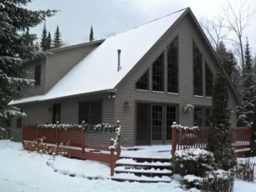

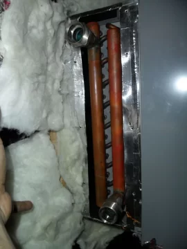

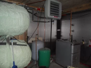

I recently helped a person install an effecta 35 boiler in a house on the East side of Northern Michigan (Alpena). He is using a 100,000 BTU heat exchanger in the furnace plenum and has 1,000 gallons of refurbished propane tank storage. Early on he thought the 35 kw effecta lambda boiler was too small but I made a visit to him over the holidays and he said everything is working great. The day I was there the outside temps. were in the teens and he was making one burn per day.
The house is 2,6000 sq. ft and was built 10 years ago. One half of the house is an A frame construction with 24' ceilings and that end of the house is pretty much 100% glass (thus quite a bit of heatloss).
The boiler and sprayfoam insulated tanks are in his 30' x 40' pole barn and his boiler water is going underground for approx. 65' through Z Flex silver wrapped 1" PAP pipe. The system has been designed so that the circ. pump only moves water from the top of tank to the house when the furnace fan comes on (this is done using an Azel temp. setpoint controller and switching relay).
