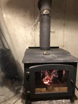

I live in a newer colonial house made in 1998. The living area is 1512 sq ft. Half the basement is a garage and the other half is unfinished basement. I currently have an englander 30 in the basement and it’ll heat the whole house but I tend to run it hot so the house temps stay fairly comfortable. I plan to move the stove to the main floor in the next few years. I’ll have to figure out a hearth pad and the whole installation later on but for now can someone tell me if this stove will be too big for the house? The stove doesn’t like to be choked down (low and slow) but does like higher temps like 650+-50. It requires constant attention in the first hour of a load to make sure it doesn’t overfire. I tend to rely on the blower to keep the temps under control. I feel like if I move this beast to the main floor it’ll be 80+ degrees all the time and I’ll be opening windows. What does everyone think? Should I look for a smaller stove?

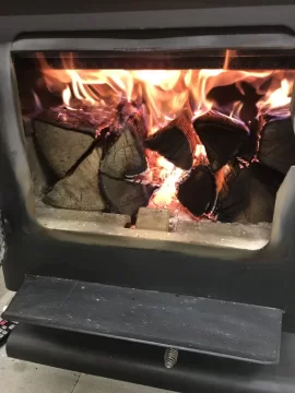

Here’s a picture with some good secondaries.
![Is Englander 30 too big? Is Englander 30 too big?](https://www.hearth.com/talk/data/attachments/241/241457-905b74d58bac9fcf79fd72813168da37.jpg)
