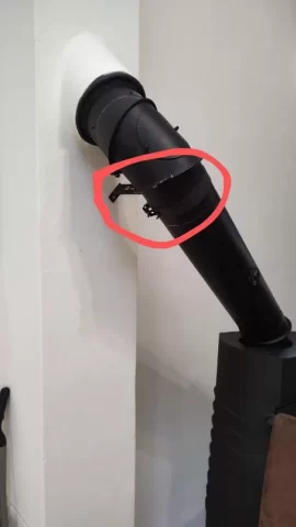

Im at my witts end trying to figure out how i can instal the pipe from the Chamane to the T-piece. Problem is, i cant install it directly below (in a vertical pipe style) cant move TV anywhere else.
We need to have it off=set to the right of the T-piece (wall connection). The chimney flue is a 200mm Pumice stone coming through the top of the roof.
Im reading conflicting things. Questions i have.
1. How long should the vertical pipe from burner be before the turn? (minimum 30cms? Or more than 60?)
2. What angle (elbow piece) should i use? (30 degree? 45 degree?)
Would love to hear people's thoughts. The shops here are really useless when it comes to advise.
In photos, the top of the burner (we love this Invicta chamane burner) (of course manual is in French only, which does not help).
top of the burner to the bottom of T-piece (in the wall, angled down) is approx 700mm (70cm)
i also added two options i thought might be possible.
1. diagonal (but not possible if you first need vertical pipe length)
2. "up and across"
or
3 ? Is there an even better way to attach the pipe?
The top of the burner is 180mm and the t-piece in wall is 200mm.
Many thanks for your help. We have two young children in the house and really want to make the connection as safe as possible.

![invicta chamane 14 installation.jpg invicta chamane 14 installation.jpg](https://www.hearth.com/talk/data/attachments/300/300701-1b46e4d165b95ba81eda447c3f9a7c6a.jpg)
