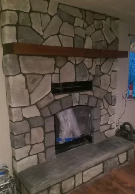

Thanks Super 27 for your help. The Opel 3 fireplace is installed with stone facing and looks great (see picture). The only problem at this point is the bottom louver. It doesn't lock into place and occasionally falls forward. It looks like the contractors didn't use the supplied magnet brackets and they laid the stone mortar too close to the edges so it couldn't be used. Contacting them today about options there.

that stone work looks great.
