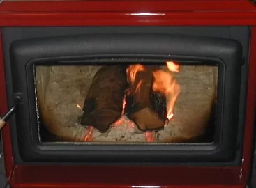

Pictured is the very dirtiest my glass will get. This is from about a week or two of burning in the Fall or Spring when less wood/heat is needed. In the winter i might get a spot 2"-3" big on the bottom left that looks foggy . Pictured is dampened down about 15% air supply.

more information ............How is it compared to the picture above? is this year around? only spring/fall? are you getting just the bottom corners browned or is the whole glass going brown. What kind of wood do you burn?
