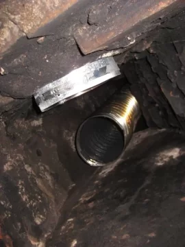

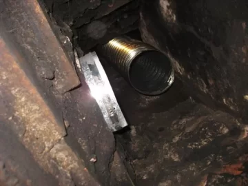

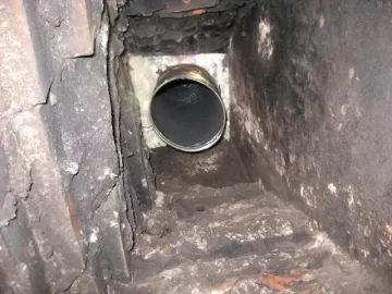

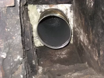

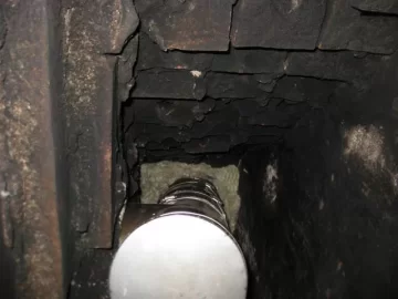

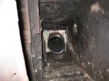

well everything went pretty good. seem to go down easy just shook the like like crazy and kept packing it. i took some pics of where i had to block off on the bottom. what a pita to get up in there.. but im hoping everything is in there good. My new blaze king should arrive end of next week so wanted to get this all done. now i just need to get the double smoke pipe..
heres the fun

Nice,you should have a nice warm chimney there.
Yes sir. its really a good thing im skinny because i wouldnt have been able to get the block off plate up there. lol
