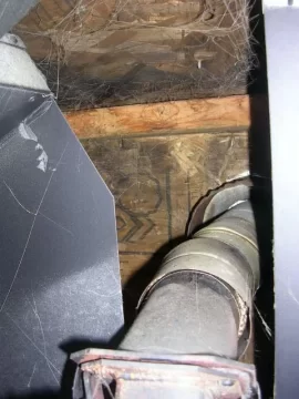

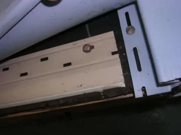

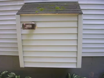

Heres some pics..
  • [Hearth.com] Insulating a pellet insert?
What is in the 1st pic it looks like smaller pipe being shoved into bigger pipe with some rope gasket shoved in to seal it
1) you may want to get a proper thimble for the pass thru to comply with the clearances..... Especially on the outside with that vinyl siding...
2) what kind of cap is that?????
3) Clearance from wall I think is 12"(for discharge)(EDIT****** it's 6" from the wall) and from vegetation 36" I'll post a simpson link below... It's a horizontal termination and you'll have lots of sparks coming out of the end of that pipe......

I would have your friend rip that box out and start over it may be easier.
It should also have support on the bottom of that box....

Mmmm... wow... that's scary. Personally I would call a pro and have them come look at it and see what needs to be done to make the install right. You definitely should pick up some proper venting and a wall thimble (which will keep the new insulation away from the pipe). Also, as I said, check to make sure the shroud and all other parts are on there required for a "Built-In" installation. As GVA suggested it might not be a bad idea to get a the OAK (outside air kit) since it would be a pretty simple install. Read over the manual and make sure all the clearances are met with the unit and vent termination. If you have any questions about the manual you can call Quad technical (should be a number on the manual) and they are really helpful as well.
Goes to show... like I said before, fireplaces don't make very good windows. It is basically installed outside. Imagine sawzalling a hole the size of a pellet insert right in the side of your house and just leaving it open all winter. What you have here would be the equivalent of leaving the wall behind the refrigerator bare (on an outside wall) because you wont ever see it.
