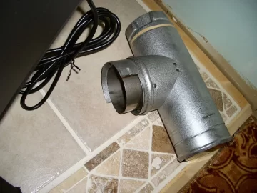

I had a similar problem in that the exhaust pipe in my stove was not centered perfectly with the hole in the rear panel of the stove not allowing it to fully seat. So I had to cut a small section of the outside of the vent pipe off so it would go all the way in for a tight fit.
Steve
  • [Hearth.com] Installers : Need Your Help
I'm guessing from your picture you attached the Tee directly to the stove's vent pipe. Duravent has an Appliance Adapter which transitions from the single walled output vent to the double wall twist lock used for the Duravent part connections. It's supposed to be used in between the stove and Duravent piping. That would have eliminated the need for the cutout you made. It also allows you to silicone & screw the adapter to the stove and still be able to take the Tee off without a problem.
