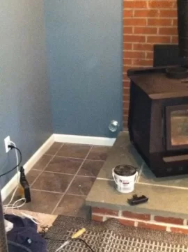

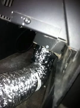

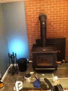

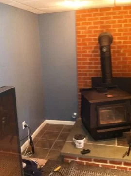

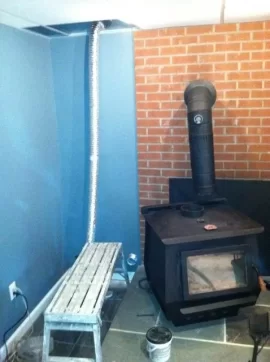

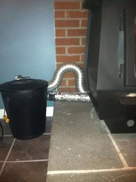

Well i got the oak installed. now to wait from some weather to burn see how it works. i was able to snake it in behind the wall. nice having a drop ceiling to snake things in behind the wall. i just made a metal cap at my shop just a little smaller than the inside diameter of the opening then cut a 3 inch hole tap in off of that and furnace cemented it up and and then ran the hose off of that.
