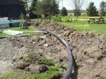

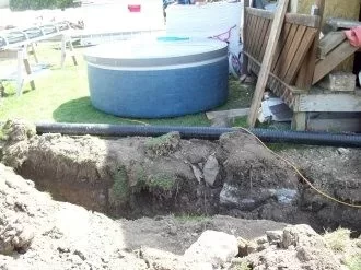

Started the instalation of my new gassifier boiler heating system. Put 110' 1 1/4" themopex in the ground. Not as easy as I thought it would be. first hit a footer right when I started, then another footer. Had to dig both out.

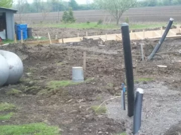

Luckly I had a backhoe and not a trencher. Then the foundation wall (crawlspace) that I thought was going to be a cynder block was actually a 13" cement footer with 1 row of block above the dirt. It took a little over an hour to drill a 4" hole threw that. Then had a hard time pushing it threw the hole but got it with the help of three friends. also picked up two 500 gal propane tanks. No turning back now !! On the way home with the tanks
