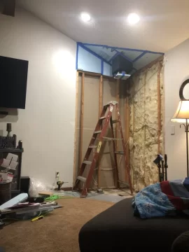

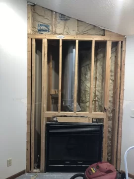

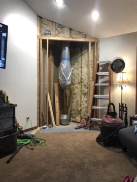

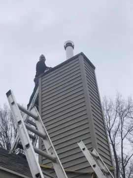

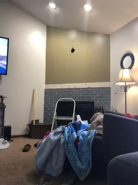

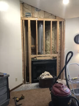

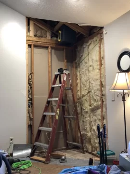

so my daughter was home sick from school for 2 days and I got bored while hanging around the house, so I started into my wood stove install project. I hope I have done everything correct from reading on here. I used Supervent class A from ceiling up.
I tore out the old factory pos and removed the old liner. I did however keep 2 5’ sections of the old liner as it was 11” and used that as my guide up the chase. All clearances of 2” have been met and exceeded. Now just waiting on some finishing parts to arrive. I have temporarily sealed the ceiling with foam board until I can finish the walls and ceiling.
I don’t need anything special for the chimney in the chase?
