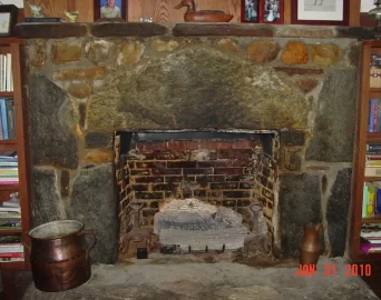

I'm leaning heavily towards a free standing stove in my old masonry fireplace and I've been told a few different things:
*A stove could be put in minus legs or pedestal and/or
*A stove could be put in by removing bricks as needed.
*I need a cast iron because of the pipe placement.
*A pipe could be put in that would create 2 angles.
*I might as well get an insert because a free-standing should still be plated in.
Nobody has actually looked at my place yet, but I'm inclined to think I would still get the same responses. Does any of this sound reasonable? Unreasonable? Can the stove be backed right up into my old hearth or does there need to be some clearance there?
Pics and specs again
Depth 20.5”
Depth + hearth 48”
Width 37”
Height in front 33”
Height in the back-it begins curving forward at 22”

You're doing fine. Keep the details straight and the salespeople separate from folks with real knowledge and good ideas. This is true for local dealers and internet opinions. Walk away from plain silly suggestions like a double-elbow connector.
Looks like you have a good sized opening to fit the stove in. Just keep in mind that you will need a minimum of 16 inches of hearth in front of the door opening. Most stove manuals have diagrams for minimum clearances with single or double wall connectors.
Some stoves come standard with rear heat shields that dramatically reduce the minimum clearances, and can also be added to some stoves for the cost of the part.
if you want to avoid having to extend your hearth you should definitely look at the minimum clearance requirements for each of your prospective stoves.
Hope this helps!
One other measurement that would be helpful is to have the depth of the lintel. This is the top support of the fireplace opening. What is the measurement from the front of the fireplace to where the throat of the chimney starts? That will determine how far a top exit stove will sit in the fireplace if that is the final choice.
If I am making the correct measurement, this is 4"
Anthony, thanks for the link to that thread.
That is nice and shallow. It will broaden the options for a top vent stove and will place more of it out on the hearth. All good. Some top vent stoves have the flue collar a bit more forward than others.

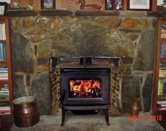

Here's a peek at what it could look like with a nice T5 on the hearth.
  • [Hearth.com] Installation and stove choices
Oh that's dreamy. Can I say that on this forum? :red: It feels warmer already.
That's sweet, K !!!

thats just the set up i was thinking for this, that fireplace is to nice to block any of the stone work.
Call it dreamy. Call it whatever you want. A hearth stove installation is what that beautiful (dreamy) old stone chimney and hearth just cry out for. Your choices are many. You will want a full Stainless Steel liner from the stove up the flue to daylight. You will want a block-off plate around the liner in the chimney about where the damper/smoke shelf is, to limit the loss of heat up the flue around the liner. Any number of stoves are available that would work for you. Pretty much comes down to what you prefer and what you feel you can afford. Rick
