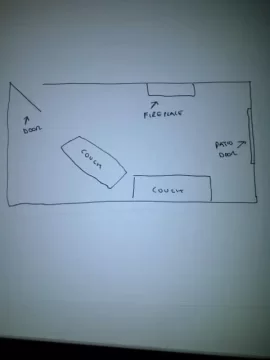

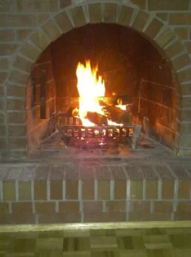

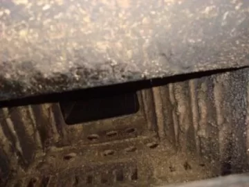

Hi guys, I have an old missionary wood burning fireplace, which is currently unusable because of a smoke chamber which has become a fire hazard due to creosote build up. We would like to do something about this, but an issue that we have is the fact that we plan on installing a unit in a family room which is about 230 square feet and is pretty much closed off to the rest of the house other than a doorway leading to a large kitchen. We do not want this room to become so hot that its uncomfortable.
A supplier came in yesterday and quoted $4,600.00 for the Regency Alterra 1250(with blower) with liner and cap as well as a couple of minor alterations to the bricks. I don't think we would need the blower considering the room size and the fact that the air would not escape easily.
Considering we would only want to use the fireplace for ambiance and not for heat, would it be better to forget the insert idea, and order new new steel doors that could seal and fixing the smoke chamber and liner?
