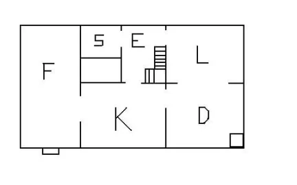

I recently purchased a Enviro M-55 at seasons end. Now its time to install.
I have two locations to work with. One involves removing a propane insert............not my favorite appliance.
or placing at other end of house in room "D". Hopefully my diagram is attached with the rooms identified by letter.
Room "F" is currently where propane insert is, this room is 16'x24' with vaulted ceiling 12' tall over the garage.
The rest of the rooms are the main body of the house with full basement under and second floor bedrooms over.
The house was built in 2002, R-13 walls and double pane windows. Circulation should be good, most rooms have
two doorways, also considering connecting room "S" with room "F".
Room "F" total volume = 4200 cu.ft.
Main house 36'x28'x8' = 8064 cu.ft.
I beleive either location should be OK for heating most of the first floor, however room "D" may get more heat to
the second floor. If I install here I would keep insert in room "F".
Any advice would be appreciated.
Yes I will post pics when she's in!
