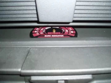

I put the Rutland magnetic thermometer on the actual top of my insert, in the air channel itself. That way I am getting a direct temperature reading of the stove itself. The only thing that could impact it is the air flow from the fan, however I always keep the fan on low, and the back side of the thermometer has a 3 sided metal shield around the bimetallic coil, so I don't think the air impacts the readings much. The photo below shows my setup, except for one difference... I have rotated the thermometer 180 degrees, so the rounded edge faces out. The reason for this is that I can see the 300-700 degree temperature range easier, even though the numbers are upside-down. Normal operating temperature is around 650, regular highs of 800, maximim high of over 900, lows with secondary of about 450 or so.
-- Mike
  • [Hearth.com] Insert "top" temperature?
