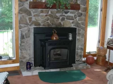

We have a fieldstone Rumford fireplace. Had the same problem with our Harman insert. Had two granite columns cemented to the front of the fireplace to provide a nice flat surface for the surround. Had a piece of sheetmetal cut to fill in the oversize space. Looke fine. See attached image.
