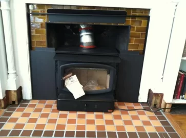

Just thought I'd come back and post the conclusion of the story in case anyone with a similar situation finds this thread. What the chimney guys did was (1) pull up the liner from the top just enough to attach another short section of the same dimension rectangular liner, then (2) drop the liner with the extension down the chimney into the firebox (after knocking out a lot of brick that was in the way) where they attached (1) an adapter from rectangular to 6" round, and (2) an adjustable elbow to compensate for the fact that the chimney was about 3" off center relative to the fireplace. I only got to use it a couple of times last spring; the draft is definitely very strong, so I hope it doesn't get too much stronger in colder weather. [Hearth.com] Insert direct connect questions

red high temp silicone is rated for 600-650*, sadly, not to be used on woodstove flue collars.
Yep, at some point that's going to be stinking the joint up.
pen

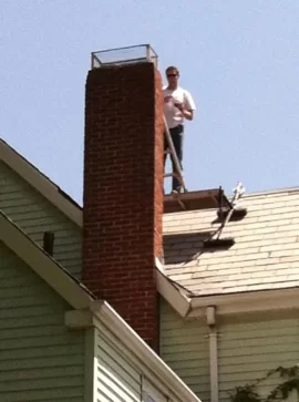

Re:cleaning. They said they will clean from the top down, though it will be more expensive because they have to set up scaffolding on the roof (see photo). re: silicone. damn, these guys are supposed to be pros, that sounds like a rookie mistake. I assume at this point the only thing to do is let it eventually burn off (assuming it does actually get hot enough)? Is it worth trying to scrape it all off with a knife? If it does burn off, do I need to re-seal with something else or can I just leave it unsealed?[Hearth.com] Insert direct connect questions
Not sure why you'd need to have an air-tight seal at that junction. You should have a vacuum inside that pipe, due to the chimney draw. Excepting backpuffing situations, a stove and chimney are always under vacuum / no reason for smoke to escape a loose joint.
If you have already burned in that stove then it has already melted and burned up the silicone, no real need to seal it if it is connected right, only other thing you could use is mill-pac (good luck finding it local).
