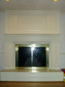

Elk - Your insight would be greatly appreciated too. I tried to attach a picture of the current hearth, but the fiel was too large. I will add the picture later.

on the picture send it e-mail to yourself that should reduce the size to be able to post it here from your own e-mail attachment
cut and paste it in your pictures folder or copy too I have to remember windows been too long on a Mac.
If I see what your current setup I will know if you can alter your surounfd to comply or to use a heat shield

Elk - Here is the picture of the hearth.
Thanks for your help.
Dennis

The side note about clearances to combustables is based on NFPA 211 Code . I then researched the stove owner's manual.
75,000 BTU heat and I can see why combustiables are an issue. Me I would remodel the mantal and suround to be compliant
But easy for me I do that for a living. Ever see plaster moldings used as the surounds Plaster is considered non combustiable,
You are right every large BTU stove will quote clearance issues. Plan A remodel your existing wood setup to be compliant
Plan B find a lower BTU stove that would be code clearance compliant . Plan C use a smaller stove in your family room

I see why she doesn't want it remodeled. Go with the smaller stove.
