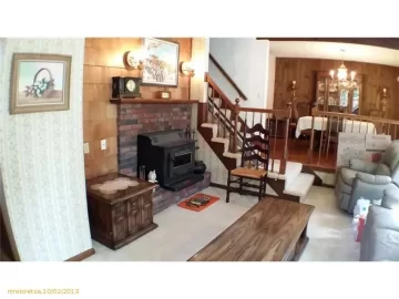

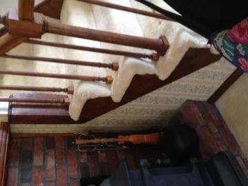

I have a picture of hearth with the All Nighter that I just removed. The challenge I am having is the staircase to the right of the stove I only have 12.5 inch from edge of fire box to stairs hoping flush insert will give me clearance needed with only thin heat shield. not sure I can get away with wood stove. By the way the rug is coming out and stairs will be all wood. [Hearth.com] Inexpensive Inserts, Are they usable or Junk?[Hearth.com] Inexpensive Inserts, Are they usable or Junk?

I read that the NC-30 has a side heat shield option which reduces the clearance requirement to 5".
Thats interesting I guess I assumed that flush insert would be my only real option. I will look at that and talk to the wife think she is sold on the look of insert. I really just want something safe, inexpensive, and functional.
I guess you need to read the link I gave above but I am thinking since your pipe sonnectionn is up inside the fireplace you can go with the measurement they speak about when using double walled connector pipe. Plus if part of the stove is sittinng back in the fireplace gives some protection.
I think Mike from Englandar is saying 6" here:
now getting to the pipe clearance and stove clearance mess; when the stoves are tested for UL 1482 compliance(not epa mind you , thats emmissions, UL is safety) the clearances recorded and specified are made with no regard for where this places the connector pipe its done strictly by reading heat output from stove surfaces at different distances (they do this with moving walls that have thermocouplers mounted on them) so they are testing the stove heat output , not the connectors heat output, therefore NFPA 211 clearances have to be observed 18" for single wall 6" for double wall
