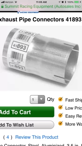

Pic 2 - Summit racing muffler adapter pipe 3.5” in diameter
