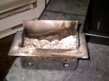

Last evening I shut the stove down for a quick cleaning and to switch to hi/low for the night. There was still about 10 pounds of Heartland pellets left in the hopper so I decided to see what the PAH thinks of that last bag of Indecks. I kept an eye on the stove all evening and everything seemed to be going ok so I went to bed. I got up this morning and glanced at the Tstat on my way to the coffee pot, 2* above the set point. Normal for a mild night with the stove in hi/low, the stove most likely never came off of low all night. I get to the living room and look at the stove, the glass looks about right for an all night low burn. The flame looked ok, which is suprising considering what I saw when I peeked into the burn pot (pic attached). :bug: I'm glad there's only thrity pounds of these left.
Will adding more LBA help to burn this crap up? If so, since I'm already at 5, how much more do you think it will take?
