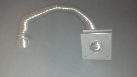

OAK inlet on the back of the stove is to the left and lower - the 2" pipe. The small screen installed at the end that is attached to the aluminum flex pipe is the OAK. I prefer my kit as it has a small hood along with a screen on the inlet - minimizes potential wind or moisture problems.

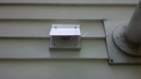

like this?
Air inlet under the flap..

Mine is not integrated - separate from the exhaust set-up. Looks like a dryer vent but aluminum. It is on the west side of the house and generally gets more wind activity in the winter. Between the turbo cap on the exhaust and the hood on the OAK, no issues due to wind so far... likely would have seen something in 3 years if we were going to have problems. The stove dealer didn't figure we needed the OAK but I added it about 2 weeks later...
Because of the Inside corner of the house where we needed the stove,My Exhaust faces not only Northern winds, but wind from a lake 300 yards away.
Not a bit of problem so far with it this way. I really think the design of the Outside rig really helps with blocking Weather..

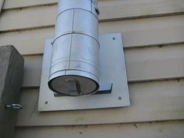

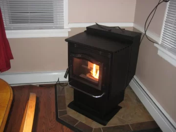

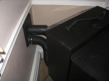

Here's a few pictures of mine:
Before Installation:
In this video, did they install an OAK?

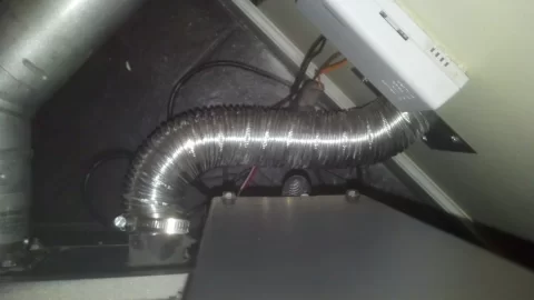

After installation (inside view):

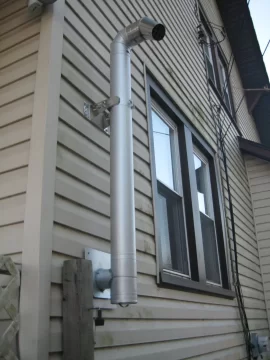

After installation (outside view):

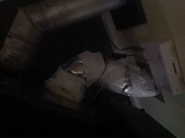

Inside view after insulating:
