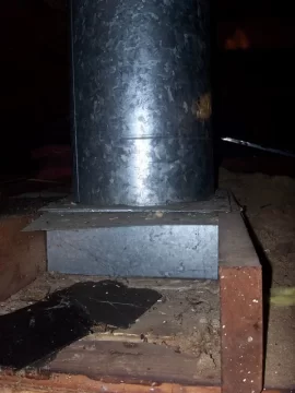

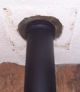

I just had an old 70's Preway taken out and replaced with a new small Country stove... The old stove was here when we bought the house. Once the old stove and piping were taken out, and the new one installed, we saw that the support box appears to be installed in the attic, with just a small lip coming through the ceiling where the stove pipe attaches. We didn't think anything of it, but since doing our first couple of fires, the ring in the ceiling is getting quite hot (around 150 degrees F). That got us looking around for info and that's when we realized that the support box is in the attic- and most of the info we have found so far shows the support box installed on the ceiling, not in the attic. Our biggest concern is that the drywall ceiling is only about 2 inches away from the ring that the stove pipe is attached to- and if it's getting to 150 degrees, it seems a bit unsafe. I've attached pics... any thoughts on this setup and whether it looks acceptable or whether we should have it evaluated by a professional would be appreciated. (BTW, we had the store where we bought the new stove do the install, the guy and his wife who installed didn't say anything, so maybe we are just worrying for nothing...). Thanks!!
