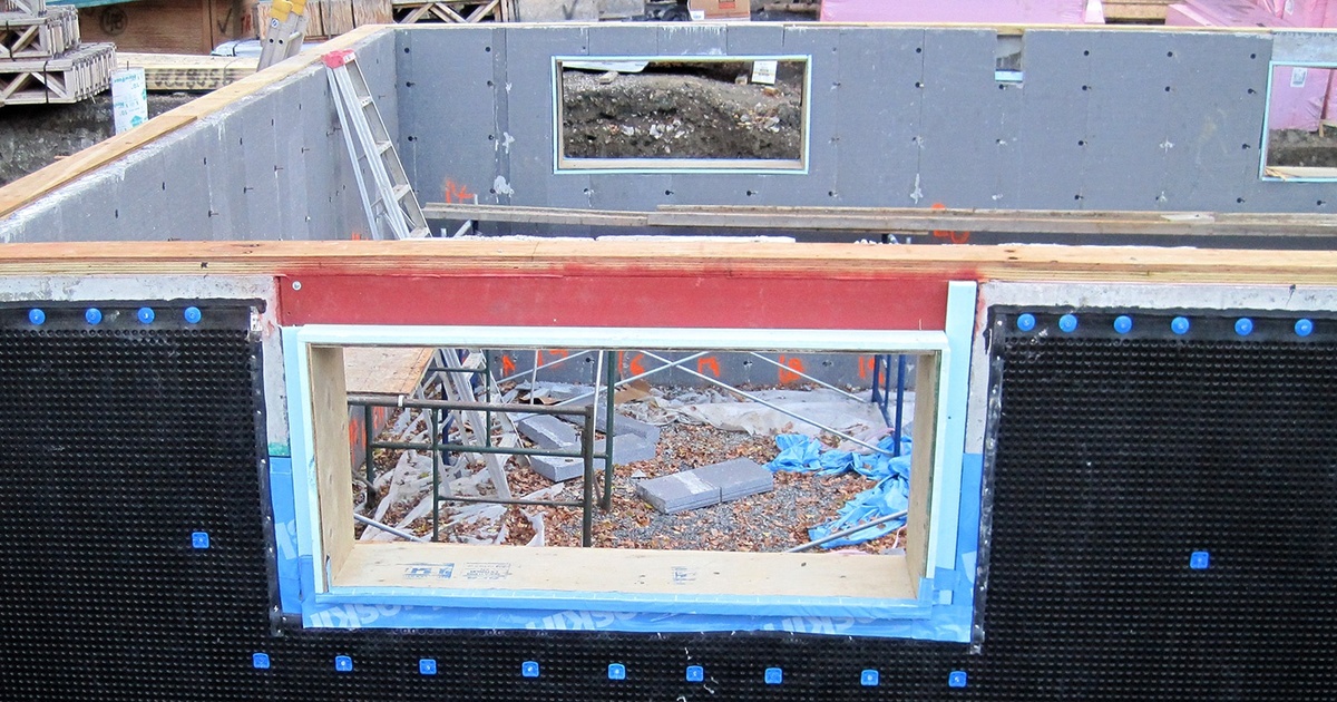

You should consider installing insulation and a vertical drainage system on the exterior of your basement walls.
