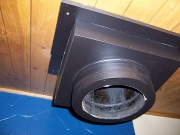

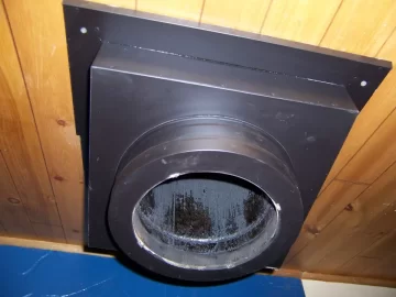

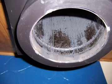

I'm trying to determine what stove pipe (8") to buy to fix the screw up by the previous owner. I've looked the ceiling box all over and can't find a mfg name or markings on it. I understand I need to know the mfg to order the corresponding pipe. I believe the stove was installed in 2002 by an idiot and I want it right for this winter. I know I should have done it several months ago but at 71 sometimes I just need to be in the mood to do something. My wife saw to it this time. Any help would be greatly appreciated.

Can you see any labeling on the Class A ABOVE the ceiling support?
Are you installing a stove with an 8" flue collar?
There are absolutely no markings on the base, circular section or anywhere inside the ceiling. The stove take off is 7 5/8" iD so I'll need a stovetop adapter then the pipe then a slip joint pipe to go into the ceiling box. I bought a couple sections of 8" imperial snap lock but that's wasted money I now know!

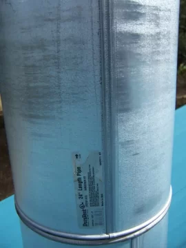

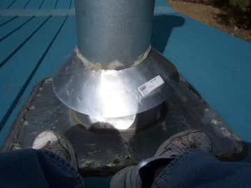

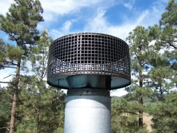

Well that was worth the climb. The pipe coming thru the roof is Duravent Duratech HT made 3/07/2011. So If I understand things correctly I need to buy Duravent pipe? Single or double wall? I've attached 3 roof top photos.

You'll need to get the DuraVent adapter. If the stove pipe will be less than 18" away from the wall it will need to be double-wall.
