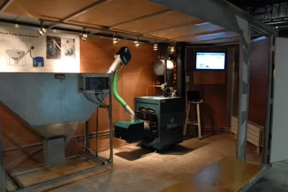

Have you looked at Myson heaters as well? These too are a bit pricey, but they have great btu density for their size. We recently installed one in our show trailer with the quiktrak radiant flooring and run them off the same zone with a mixing manifold. It works great and I like the ability to regulate flow to either the radiant or the panel (I've attached a photo). Here's a link to some of the Myson units:
