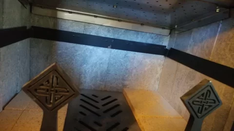

Here's the inside of my stove right after it was installed (you'll ever see it that clean again lol!!) The plate where the secondaries happen is the metal sheet on top of the firebox with the holes.
I don't know about any issues with cracks in the secondary plate or any other metal parts/areas of the stove but sometimes the firebricks or soapstone blocks on the inside of the stove can crack during shipping but they'll send you the correct sized replacement for free if you notice one is broke after you get the stove put in.
