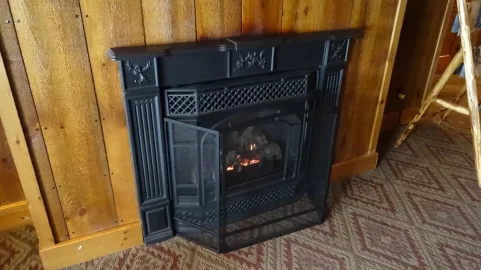

Customer sent me this asking if I knew what make/model it was. Anyone recognize it? Im drifting thru google images in the meantime.
  • Id on a gas unit?
VC DV 360. Customer wanted to know what it is and why it was installed with wood behind the surround. I think I got this one licked!
From looking at the manual pages 6 and 7, as long as that wood trim isn't overlapping the trim of the fireplace at all and doesn't fall inside the 41" wide x 38 1/2" tall framing dimensions. Bob, does that sound about right?
That's how I read it, too, Frank. Drywall can come right up to the sides & top (0" Clearance)
& paper is a little more combustible than wood. As long as there is no overlap of the UNIT,
that install is good.
