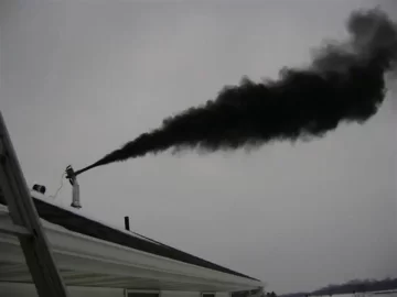

works fine with vertical vents also, just run the brush down first to loosen everything up.
  • [Hearth.com] I TRIED to cheat on my stove cleaning....
A guy posted a video of the leaf blower on his roof the other day, vertical stack. Looked like it worked awesome. Huge black cloud or debris settled in his back yard.
Good thought about the VAC switch. I think if I did it, I would disconnect the hose for that so it would not get damaged. Leave the door open and run inside to shut the door briefly for some good suction.
If that pic doesn't get folks wondering how much crap is in their system nothing will...
I use a old bath towel around the pipe to make a seal, then just fire it up and let the leaf blower do its job. sour you are halodind it but have a beer and injoy the soot and think that your not giving the oil co. and of your money and your house is warmer that the next. Also it gets the wife or kids involved in scraping the stove when your out side.
That is sure some beautiful pic of the rooftop volcano. I did mine like that last week and didn't do the brush. It looked neat but not that industrial. Next time I have to make up a converter to get a better seal. I just stuck mine up against the pipes and it worked pretty well. It doesn't make much difference where I live but if it is in the city I would do that when the wind is positively howling so the neighbors don't notice.
