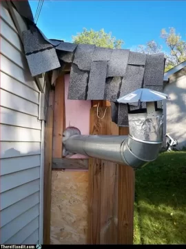

BB, I thinks I dont see a wall thimble in that set up. And the single wall needs a little more DOWNWARD angle, and a "weep" hole drilled in the 90 to let the drippins out. Other than that it looks a-okBrotherBart said:Heck. Works for my stove.
