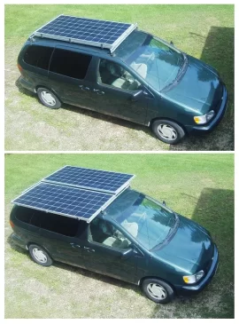

I know it's too big, now. Old batteries 240 Ah.. I plan to have both panels stacked on the roof of a minivan traveling, accessing one panel, then on site the lower panel is pulled out from the side using a quasi full extending drawer slide. Would like to avoid the wasteful upgrading suffered from 90% of the videos I've seen. Guess the question is, what's the harm? Is it possible idle PV panels do damage or something? It'll all be transferable to my next vehicle just like my 20 year old roof rack. Camping, avoiding motel bills, microwave, maybe a fridge, diesel heater, daytime AC, jumping bolts stranded on the side of the road . Who knows, maybe the end of civilization.What are the solar panels being installed on? How big of batteries are they charging and what are the batteries for?

The photo is definitely not as dramatic as I was expecting. Based on your previous post I was hoping to see some solar panels attached to the top of your minivan.Just got the mppt and drained one battery with a 50w bulb over night, so everything being bench tested in my back yard.
Give me time. Mount design is in flux. It's easier when I knew what the pieces look like. A fully extending drawer slide design is problematic. The present design has both panels on quasi halfway extending drawer slides. Top panel go's half way to the left, bottom half way right.The photo is definitely not as dramatic as I was expecting. Based on your previous post I was hoping to see some solar panels attached to the top of your minivan.
Think I'll risk old flooded Walmart marine batteries before risking thousands on LiFePo4s. The panels are so overkill the batteries should keep topped up no matter the season. Just hold off on the big draws til daylight or run the engine ten minutes to brewing coffee. How much can idling a 3 liter engine cost anyway?Lithium batteries are far better suited for PV but they are still expensive and far less forgiving so they need a good BMS built into keep them from being overcharged. They also have narrower temp range.
