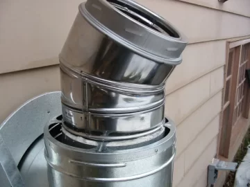

why is my dura vent clean out tee 10" wide and the 30 degree 8" wide?? they are both dura vent 6" parts.
BeGreen said:?? side profile dimension. Elbow has an offset.
Tee = 6"(pipe)+2"(insulation)+2"(snout)
johnnywarm said:why is my dura vent clean out tee 10" wide and the 30 degree 8" wide?? they are both dura vent 6" parts.
weezer4117 said:johnnywarm said:why is my dura vent clean out tee 10" wide and the 30 degree 8" wide?? they are both dura vent 6" parts.
the "t" is triple wall insulated and the elbow is double wall insulated. same manufacturer, different model.
