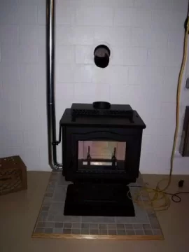

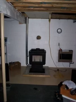

HERE IS A PIC OF MY NEW SET UP. MY OLD HOUSE HAD A NASHUA AND I HEATED THE HOME WITH IT FOR OVER TEN YEARS BUT THE PIPE FIT RIGHT INTO THE CLAY. THIS CLAY IS AN INCH LARGER. SO ALL I NEED IS AN ADAPTER? I HAVE ONE OTHER QUESTION THERE IS A GAS HEATER NEXT TO THE STOVE WILL THIS PRESENT A SAFETY ISSUE?

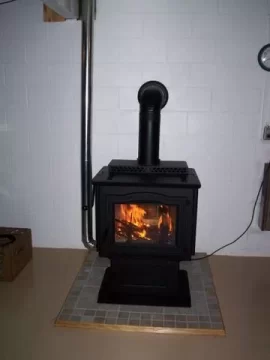

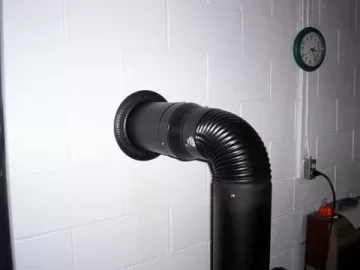

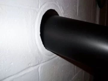

THANK YOU ALL FOR YOUR INPUT I AM UP AND RUNNING ! 24"X7"DIA. PIPE, 7"TO6" ADAPTER A COUPLE OF SHEET METAL SCREWS AND AWAY WE GO! FIRST BREAK IN FIRE WENT SMOOTHLY WORKING ON A SECOND. :coolsmile:
