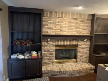

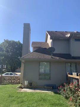

I'll try to answer questions. It is a brick face hearth. Old system appears to be slid into place, not built around. Chimney is offset to the outside, 2 story house. Fireplace store quote was $15k the only part I know anything about is labor costs, which are rivaling lawyer rates. I assume accessories are obscenely marked up as well.
You should post some photos if you want a more accurate estimate.
$15K sounds pretty high, but we don’t know what you have or what the bid was for. If it’s a high efficiency unit, with stone work, siding repairs, chase cover etc.. then it could be right on par. I’ll do it for $4,100!;lol

Yeah we need some pics to know what we are talking about.

The installer was not fixing any siding, structural stuff, or animal damage to the wood parts from when there was a tree there. Only doing fireplace and chimney specific stuff. I was to get a seperate contactor to fix those things.
Ok that is a prefab fireplace not an insert. If you want to go with something that will actually produce heat you will need switch to a high efficiency fireplace. Doing that would start at about $10000 and easily get up to $15000. What are your goals with this unit?

For one, just set a freestanding stove and run a new chimney through the chase.

Ok that is what I thought from your original post. For a fireplace that will actually provide heat to the home total installed cost will probably start at $10000 and $15000 is not out of line depending upon what unit is installed and how much modification needs to be done.
