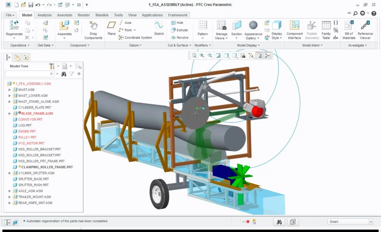

I had been around wood sawing and general firewood for many years. I have Woodmizer saw (LT30). This means there is also a large supply of slab firewood at my shop. I wanted to design my own processor and looked around at the various options available. I had a two jobs to accomplish with this processor design - slabs and split firewood and I wanted one machine to do both. Lots of chainsaw and buzz saw experience led me to lean in the large blade direction based on the blade maintenance and speed differences. I found a Ø 26-1/2" Carbide blade on Ebay. I bought the blade and started to layout how the new machine could work. I came up with a layout that I had not seen anyone else do - I wondered if it would ever work - but I went ahead and built it anyhow.
This story starts with me finding a large (Ø28") blade on ebay, buying it and laying out several concept assemblies to use it in.
This is the final/original design assembly I came up with:

Pro-e model looks like a good start. Pro-e / Creo the gift that keeps giving, just a joke as we users only curse it 3 times a day at work.
Looks like it will be "Made in Canada" this is a good thing.

I ran the ProE model simulations for all the main structural parts and made some major changes to the splitter design and smaller changes to other components.
I curse Pro-E Every time I see a file come in from a customer......

jmur1, Great to see your project come to life. I have been using Pro-e for a couple decades now and its very good to see you putting it to work on a "G JOB" here is the states this term is used for personal project. Keep us updated.
